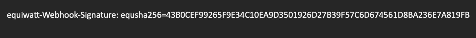

When you subscribe to webhook events you receive a webhook secret (private key). We use this secret along with the webhook payload to calculate a HASH based signature that you can use to determine the authenticity of the webhook request. This signature is included in a header called equiwatt-Webhook-Signature as equsha256={signature} . See below example.
The signature is computed by getting the HMAC-SHA256 hash of the JSON request payload using the webhook secret as the key.
You need to calculate the same signature and compare it to the signature sent by equiwatt API for securing your webhook handlers.

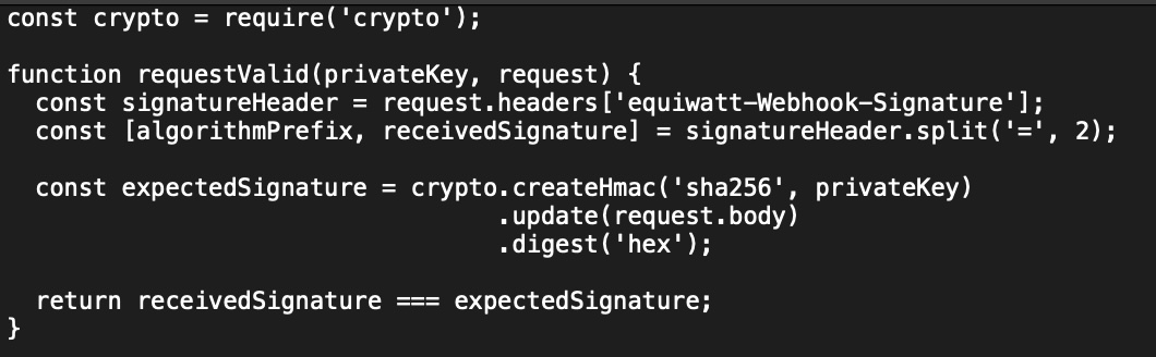

A Verification example using JavaScript

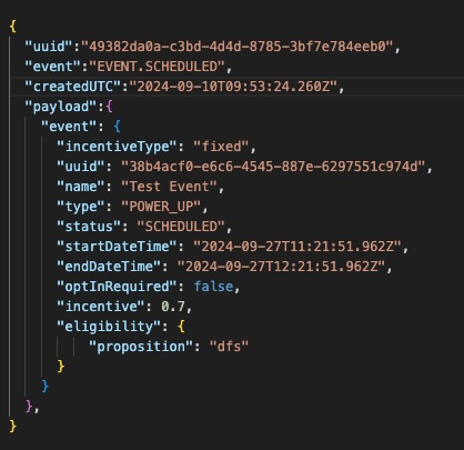

EVENT.SCHEDULED:

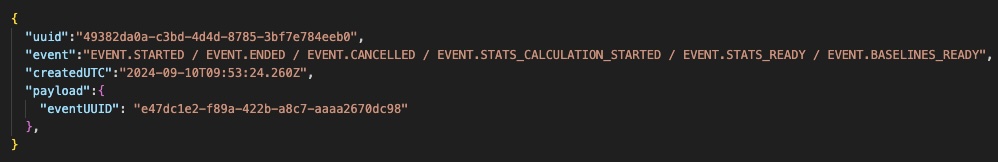

EVENT.STARTED, EVENT.ENDED, EVENT.CANCELLED, EVENT.STATS_CALCULATION_STARTED, EVENT.STATS_READY, EVENT.BASELINES_READY:

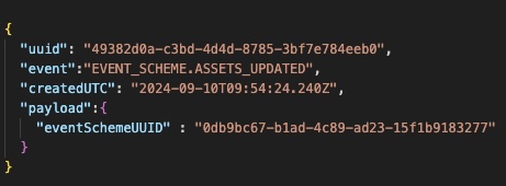

EVENT_SCHEME.ASSETS_UPDATED:
Event Scheme Asset Statuses
OPT_IN - Opt In to a Scheme.
OPT_OUT - Opt Out from a Scheme.
DUPLICATED - Asset may have registered with multiple providers.
REJECTED - Regulator has rejected the asset from participating in events under the scheme.
READY - Asset is validated and ready to participate in events under the scheme.
